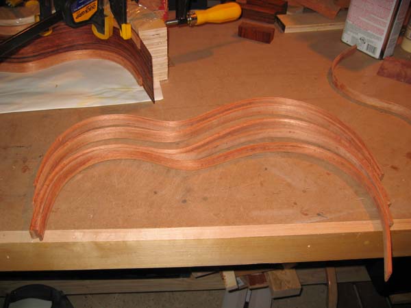

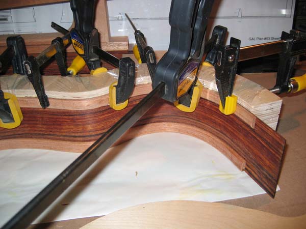

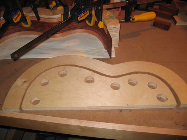

In John Bogdanovich's Classical Guitar making he explains how to make laminated linings. You making them by resawing mahogany into thin strips and then laminating 4 thin pieces 32 inches long, 5/8 inches wide and .045 inches thick. Once the 4 pieces are glued up you clamp them in a mold with the same outline as your side.
Once dried remove from the mold and use a router to round over the inside edge. (the edge not glued to the soundboard or back.)
It seems like a lot of work, but goes pretty quick. The end result is a strong lining preshaped to the contour of the side. They look nice too.
I made 8 over the past week which I have been gluing onto sides today.
Here are a couple of linings I made this week.
This is the mold.
This is a side where I am gluing on the linings.

Bogdanovich, first glues the linings up against the side mold, and then once it has dried, marks and removes the lining area where the head and tail blocks are joined.
This is my first build so I will see how it goes, but I took the side pictured above out of the mold this morning, and it is perfectly formed and surprisingly strong.
